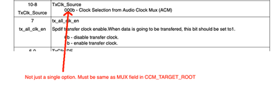

I am trying to write a SPDIF driver for the MIMX8MM5 processor. The reference manual I'm using has missing information about the clock source for the SPDIF TX.
Specifically, the TxClk_Source field of the SPDIFTxClk register, has only one option:
000b - Click Selection from Audio Clock Mux (ACM)
1-Why is there only one option? It's a 3 bit field
2-What is the Audio Clock Mux? I cannot find references to this ANYWHERE in this manual

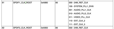

sgordon777
Clock routing: I am trying to change the CCM registers to rout other clock signals to the SPDIF TX peripheral (see picture). However, anything besides 0x000 (24Mhz) causes the system to crash.
2,076 Views

Zhiming_Liu
Hi @sgordon777
Can we please confirm whether SPDIF TX is clocked from SPDIF_CLK_ROOT
-->Yes, we can refer the setting in Linux dts, the TX clock is from SPDIF_CLK_ROOT.
For zephyr, the other PLLs in the seven options will not be generated, and the default source of SPDIF_CLK_ROOT is 24MHz. Since the PLL wasn't generated, but you wanted to use it, that's what caused the system to crash. If you need to use a PLL, these are the three steps:
1.generate the AUDIO PLL
2.set the source of SPDIF_CLK_ROOT to be the AUDIO PLL
3.cancel the gate of SPDIF_CLK_ROOT so the clock will flow correctly
Zhiming

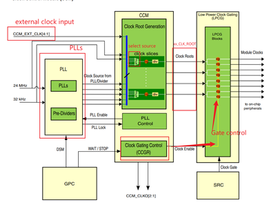

Zhiming_Liu
Hi @sgordon777

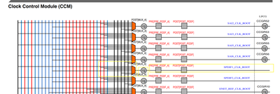

Below is the generic clock path:
24Mhz-->PLLs-->CCM-->xxx_CLK_ROOT-->LPCG gate control
External clock input-->CCM-->xxx_CLK_ROOT-->LPCG gate control
The cg unit is clock gate.
EXT_CLK_x is not PLLs, external clock from a clock input external to the chip. PLLs, 24MHz and 32KHz are clocks that can be used by default. But need generate PLLs with PLL driver to get basic PLLs.
The CCM_BASE + 0xA880 is used to select sources, EXT_CLK, PLLs or 24MHz.
Most clocks have LPCG control. To generate the SPDIF clock, you need to refer to the diagram below for the steps you need to take.
1.In zephyr os, generate PLLs, then set CCM_BASE + 0xA880 to select the source of SPDIF_CLK_ROOT.
2.disable gate of PLLs you select as you can see that there is a cg unit before you set the PRE and POST divider.
3. Then set the PRE and POST divider to get the SPDIF clock rate you want.
Zhiming
1,779 Views

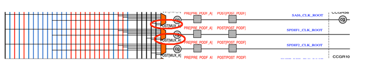

sgordon777
Thanks you. Yes, I'm aware of the clock tree chapter, I've tried to follow it for the purpose of this discussion. However, It's not very clear at all what registers these slice diagrams are referrring to:
 - There is no MUX_A field in the CCM_POST_ROOT88 register, as the above diagram implies.
- There *IS* a MUX_A field in the CCM_PRE_ROOT88 register.
- There is a "MUX field in the CCM_TARGET_ROOT88 register. This is what I've been trying to use. However as I've been saying, it locks the system if I choose a value other than 000, even if I select NON-PLL (external clocks). Also, the values I write in PREDIV, POSTDIV, and ENABLE fields for this register are completely ignored.
I hope you can clarify, Thanks
1,748 Views
Zhiming_Liu

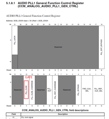

1. Select source to VIDEO_PLL1_CLK:
CCM base + 0xa880
The MUX_A here is MUX bits in CCM_TARGET_ROOT81. To write CCM_TARGET_ROOTn, write 1 to the bits you want in CCM_TARGET_ROOTn_SET. To clear bits, write 1 to the bits you want in CCM_TARGET_ROOTn_CLR.  You need to use xxx_SET, xxx_CLR, and xxx_TOG interfaces.
2. AUDIO_PLL1_OUT gate control.
CCM_ANALOG : 0x30360000+0X0
Zhiming

I'm still confused about the TxClkSource field of the SPDIF1's STC register. I was led to believe (see manual below) that 000 was the only valid option for this field. However, I could not get AudioPLL1 to rout to the SPDIF until I set this field to 001!? (I was lucky to stumble up upon this)
I'd really like some insight into this as I don;t like setting fields by trial and error. I have a simmilar question about the ClkSrc_Sel field of the SRPC register.
2) - field (bits 8:10).
#2  is where the Reference manual is flat wrong. The manual implies that 000b is the only choice, but you must set this field to the same value you've set to the CCM_TARGET_ROOTn - MUX field

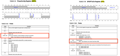

sgordon777
Thank Zhiming,
>> Only core software development has the most detailed information
>> You can refer to the settings in the Linux SPDIF driver to set up the SRPC.
I appreciate that (looking at the Linux source was next on my list, but I dont even know where to get it). I left the SRPC at 0
However, looking at Linux drivers isn't a substitute for having good bit-level documentation because I might be trying to do something in my Zephyr driver that the Linux driver doesnt do. We don't have BSP because we're designing the boards.
Can you tell me the difference between the SRPC:clocksrc and STC:clkcrc, and what each is used for?
-Field descriptions (fig2) say 0000 is the only option for both
-but the SPDIF system diagram(fig1) manual implies that SRPC:clksrc is used for muxing.
-But as I mentioned in the above pos, I had to set STC:TxClk_Source [bits 8:10] to 001 to get the AudioPLL1 to come through.
FIG1: SPDIF System diagram
FIG2: STC vs SRPC (both have txclk soruce field)
Would really appreciate clarification,
Steve

Zhiming_Liu
Hi @sgordon777
1. In Figure 13-85, SRPC[CLKSRC_SEL] should be STC[TxClk_Source].
2. ClkSrc_Sel
0000b – if (DPLL Locked) SPDIF Rx Clock else 24M_REF_CLK
0001b – if (DPLL Locked) SPDIF Rx Clock else SPDIF1_CLK_ROOT
0010b – if (DPLL Locked) SPDIF Rx Clock else SPDIF1_CLK_ROOT
0011b – if (DPLL Locked) SPDIF Rx Clock else SPDIF1_CLK_ROOT
0100b – if (DPLL Locked) SPDIF Rx Clock else SPDIF1_CLK_ROOT
0101b – 24M_REF_CLK
0110b – SPDIF1_CLK_ROOT
0111b – SPDIF1_CLK_ROOT
1000b – SPDIF1_CLK_ROOT
1001b – SPDIF1_CLK_ROOT
1010b – if (DPLL Locked) SPDIF Rx Clock else SPDIF1_CLK_ROOT
1011b – if (DPLL Locked) SPDIF Rx Clock else SPDIF1_CLK_ROOT
1100b – SPDIF1_CLK_ROOT
1101b – SPDIF1_CLK_ROOT
Others: Reserved
This information is from design team.

Zhiming
1,185 Views
sgordon777
>> Make sure the DPLL is locked
I absolutely did do this, as you can see in my query. Not only did I verify the DPLL was locked, I also verified that FreqMeas is measuring the exact right frequency of the RX signal. Look forward to hearing more.
Original query:
"3-Plug in SPDIF_IN cable and Verify PLL lock: Measrure SPDIF_Tx Biphase clock = 24.000 Mhz (according to the diagram above, this should be 24.576 Hz (the frequency of the measured PLL from SPDIF_IN)"
