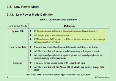

   Please note, the system idle mode:
So your ThreadX is no running, but peripheral can remain active, you can use the interrupt to wakeup the system.
 If you still want the chip run the code in the low power mode, you can consider the low power run mode.
More details, please refer to the application note:
https://www.nxp.com/docs/en/application-note/AN12085.pdf
