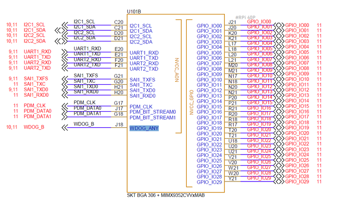

Another thing there is a pin WDOG_ANY showing as ALT0, but in RM it is showing there is no external signals for WDOG. So this WDOG are used for internal purpose only as a interrupts.

For WDOG_ANY,  it is an output,
on the EVK the iMX93 WDOG_ANY, pin J18, is wired on the PCA9451A WDOG_B, pin 28.
