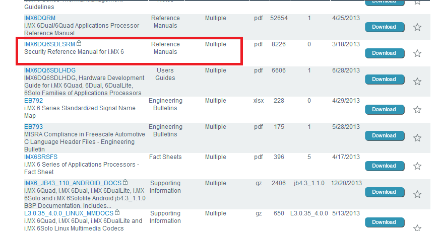

Hi,vasan,
     Please download i.mx6 security reference manual from http://www.freescale.com/webapp/sps/site/prod_summary.jsp?code=i.MX6Q&nodeId=018rH3ZrDRB24A&fpsp=1&t...
You can get messages that you want.

vsv
Hi Weldong,
Thanks much for your prompt reply. Appreciate it much.
This document is locked for access. Can a soft copy of this document be provided please here in this forum?

weidong_sun
Hi Vasan,
       You can try to download it, then operate each step according to prompt, Perhaps you will be required to input FAE's email address, at the time you can try to input my email [email protected], If it can be passed, 1 or 2 days later, e-bussiness will send a link address to me for downloading the document, then I forward this email to you. you will be authorized to download it.
      So please tell your email address here !
