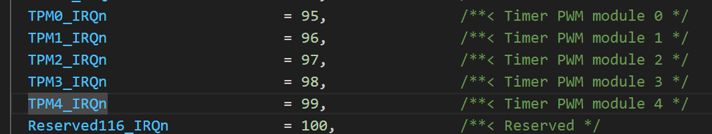

    I want TPM7 channel 2,3,4  to capture other PWM signal.
    I only found input capture demo in SDK_2_16_000_EVK-MIMX8ULP\boards\evkmimx8ulp\driver_examples\tpm.But I can't change DEMO_TPM_BASEADDR(TPM0) to TPM7, cause TPM_INTERRUPT_NUMBER does not support TPM7.
    What should I do?Is my solution feasible?

The TPM7 is designed in A35 domain, so we didn't test it before in M33 at least in the SDK source code.
If you want to assign the TPM7 in M33, you need:
1. add correct XRDC settings to assign Pbridge4->TPM7 from A35 to M33
2. set PCC4->TPM7 clock
3.use correct IRQ number.
To give M33 access to Pbridge4->TPM7 and PCC4.
struct xrdc_pac_msc_config imx8ulp_pdac[] = {
	{ 0, PAC_SLOT_ALL, {0, 7, 0, 0, 0, 0, 0, 7} }, /* PAC0 */
	{ 0, 44, {0, 7, 7, 0, 0, 0, 0, 7} }, /* PAC0 slot 44 for CGC1 */
	{ 0, 36, {0, 0, 0, 0, 0, 0, 7, 7} }, /* PAC0 slot 36 for CMC1 */
	{ 0, 41, {0, 0, 0, 0, 0, 0, 7, 7} }, /* PAC0 slot 41 for SIM_AD */
	{ 1, PAC_SLOT_ALL, {0, 7, 0, 0, 0, 0, 0, 7} }, /* PAC1 */
	{ 1, 0, {0, 7, 7, 0, 0, 0, 7, 7} }, /* PAC1 slot 0 for PCC4 */
	{ 1, 6, {0, 7, 7, 0, 0, 0, 0, 7} }, /* PAC1 slot 6 for LPUART6 */
	{ 1, 7, {0, 7, 7, 0, 0, 0, 0, 7} }, /* PAC1 slot 7 for LPUART7 */
	{ 1, 9,  {0, 7, 7, 7, 0, 0, 0, 7} }, /* SAI5 for HIFI4 and eDMA2 */
	{ 1, 12, {0, 7, 7, 0, 0, 0, 7, 7} }, /* PAC1 slot 12 for IOMUXC1 */
{ 1, 3, {0, 7, 7, 0, 0, 0, 7, 7} }/* PAC1 slot 3 for TPM7----------------------->M33 */
	{ 2, PAC_SLOT_ALL, {7, 7, 7, 7, 0, 0, 7, 7} }, /* PAC2 */
But for the TPM7 interrupt, this is deigned in GIC(A35 domain),  i need to double check if you can use it in SDK.
