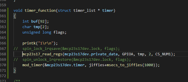

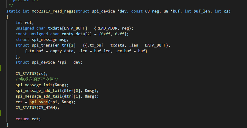

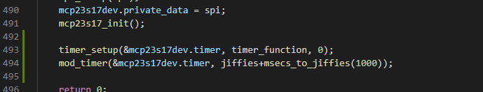

use SPI and timer respectively, which are good, but an error occurs when the timer uses spi to read the chip data. Why is this? I am using the imx6sx board. The kernel version is linux imx6sxsabresd 5.4.24-2.1.0+gbabac008e5cf #1 SMP PREEMPT Sun Jan 31 06:20:10 UTC 2021 armv7l GNU/Linux. The error message is as follows:
 BUG: scheduling while atomic: swapper/0/0/0x00000102

[  698.868228] [<80bef614>] (wait_for_completion_timeout) from [<806f5e54>] (spi_imx_transfer+0x2d0/0x464)
[  698.877648] [<806f5e54>] (spi_imx_transfer) from [<806f039c>] (spi_bitbang_transfer_one+0x50/0xa0)
[  698.886645] [<806f039c>] (spi_bitbang_transfer_one) from [<806ed448>] (spi_transfer_one_message+0x198/0x468)
[  698.896501] [<806ed448>] (spi_transfer_one_message) from [<806eda10>] (__spi_pump_messages+0x2f8/0x53c)
[  698.905915] [<806eda10>] (__spi_pump_messages) from [<806ede08>] (__spi_sync+0x1a8/0x1b0)
[  698.914109] [<806ede08>] (__spi_sync) from [<806ede34>] (spi_sync+0x24/0x3c)
[  698.921197] [<806ede34>] (spi_sync) from [<7f0003a0>] (mcp23s17_read_regs.constprop.0+0xe8/0x134 [di])
[  698.930547] [<7f0003a0>] (mcp23s17_read_regs.constprop.0 [di]) from [<7f000424>] (timer_function+0x38/0x74 [di])
[  698.940759] [<7f000424>] (timer_function [di]) from [<80190be4>] (call_timer_fn.constprop.0+0x24/0x98)
[  698.950089] [<80190be4>] (call_timer_fn.constprop.0) from [<8019127c>] (run_timer_softirq+0x3e0/0x3f8)

Is it a driver program? or your program running in user space? have you try to use ioctl like spidev?
1,769 Views
2548903578
I just added the work queue
