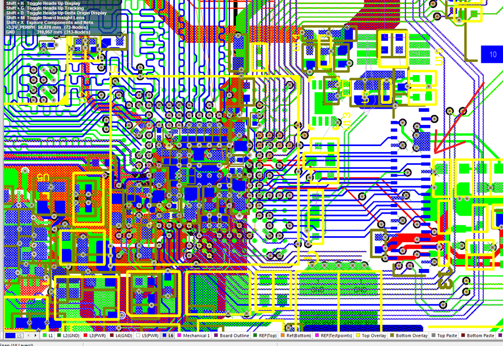

Hi all, in order to route all our stuff, i changed the demo board stackup (4 Layers) to 6 Layers (I have no termination for the DDR3 chip)
My selection was:
L1 High Speed
L2 GND
L3 POWER
L4 GND
L5 POWER
L6 High Speed
It´s similar to the demo board stackup but with 2 more layers
Can someone recommend me a good stackup for this board?
What about this?

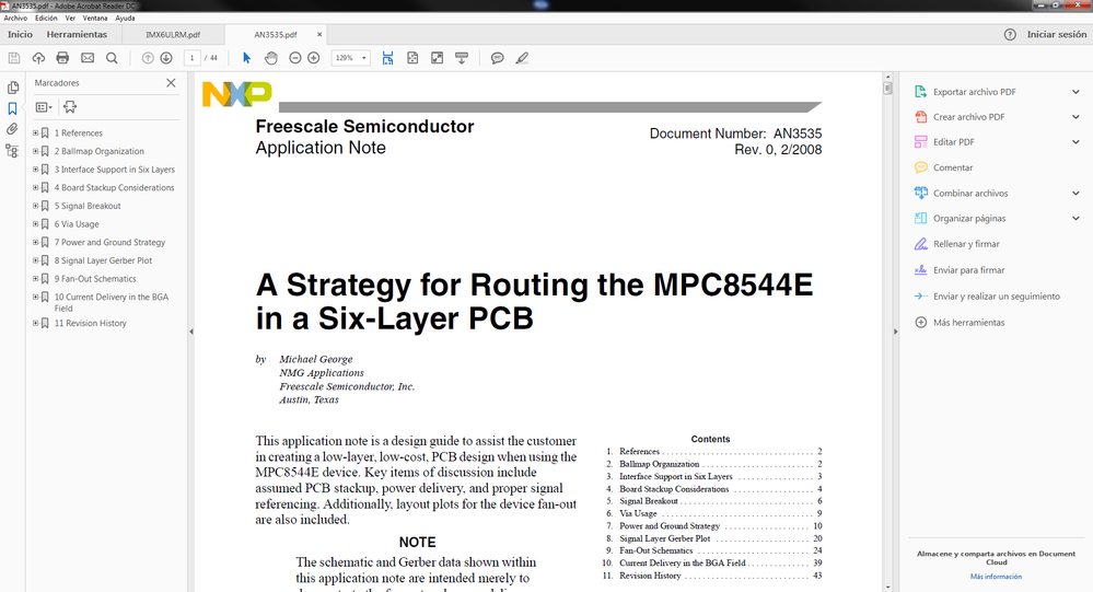

Hi Nacho
also one can look as stack considerations on p.52 presentation on
https://community.nxp.com/docs/DOC-331528
igor
1,203 Views
nachodiz
Yes but it´s 4 layers, i need a recommendation for 6 layers, the doc its nice , thank you
