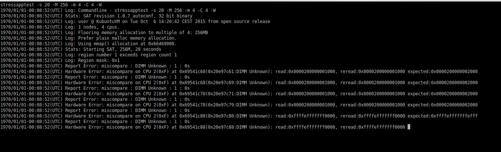

Hello out there,
i'm facing a DDR3 problem on a custom design with i.MX6. I calibrated the DDR3 with DDR Stress Test (2.2.0).
Did the write leveling succesfully, the dqs gating succesfully as well as the read and write calibration.
The DDR stress tester runs without any errors. (Here are the calibration results)

As soon as I boot into linux and run the stressapptest from google it crashes almost immediately.
Sometimes I get some miscompare results showing that the two least significant bytes are wrong.
But most of the time the application just crashes with different types of errors.
Has anyone any idea what is happening here ?

yes i ran the FSL DDR Stress tool for several hours and i used the settings i got from calibration.
Believe it or not, i fixed the problem by adjusting the ZQ resistor at the i.MX6 a little bit downwards
because i had the feeling that the impedances on my board do not match the 50 Ohm, 100 Ohm
good enough.
Now stressapptest is running without errors. I still can't understand how FSL DDR Stress tool and
memtester could'nt make out any errors while stressapptest crashed immediately. Mysterious.

The effect of reducing the resistor value of the ZQ resistor is to increase the drive strength of all your signals.
240 Ohms is specified by the JEDEC standards as the corect resistor value.
I will admit that, for testing purposes only, I have reduced the ZQ resistor value a few times, usually on the DDR device side.
But the correct way to increase drive strength is to do this in the configuartion registers. If you have IOMUX registers set to DSE of '101' or '110', try increasing them up to maximum value: '111'. If that works, then you can selectively reduce drive strength until you achieve a setting you like. For the DDR devices, this is done in the mode registers.
NXP does not recommend using different ZQ resistor values than those stated in the device datasheet. For i.MX6 processors, this value is 240 Ohm 1% resistors. If a customer uses a different value, the customer assumes all risk.
