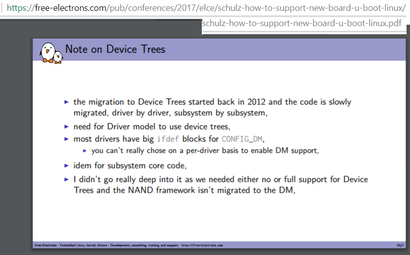

Thank you both very much for the advice.  My concern comes in part from watching this presentation...
Porting U-Boot and Linux on New ARM Boards: A Step-by-Step Guide - Quentin Schulz, Free Electrons - ...
...from Free Electrons' October 2017 presentation from Quentin Schulz. Specifically, 24 minutes into Quentin's presentation,.. see this slide...
How-to-support new boards in u-boot and linux - note on device trees in uboot.png
...but, I too saw the CONFIG_DM_options that Fabio mentioned. So, definitely some conflicting info here. Perhaps Quentin's information is out-of-date? With each of the CONFIG_DM_options -> it sure looks like intent is support should be there on a per-driver basis to enable DM support. Right? :smileyhappy:

Hi DJ Regan,
The specific slide you shared is about Device Tree, not Driver Model.
I was not able to identify an inconsistency.
Fabio Estevam

djregan
Hi Fabio...  Right... All of this understanding is per Simon Glass's presentation that I mentioned in my original post for this discussion thread.
The new uBoot Driver Model attempts to configure hardware per the device tree, in the similar way that the linux kernel attempts to configure hardware per the device tree.
So... again... my concern was Quentin's statement "you cant really chose on a per driver basis to enable DM support". In looking at the intent for the defines with prefix CONFIG_DM_option, the intent appears to be going against the statement in bold.
I will experiment.... and see what can be driven by the device tree, and what appears not to be drive-able from the device tree.
