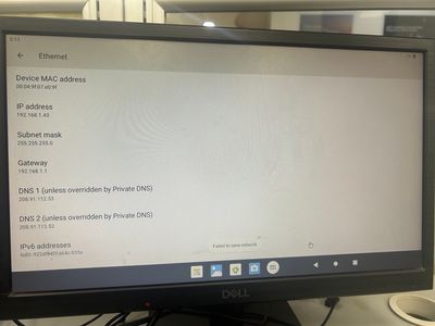

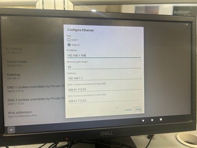

We are using IMX8MP EVK with imx-android-13.0.0_1.2.0 ;our Objective is to update Static IP for Ethernet from UI
Setting-> Internet ->  Ethernet -> Ethernet Configuration -> Add Ethernet parameters and save
We got a Toast message : Failed to save network
Attached Picture for reference
We would like to confirm it as limitation or Bug in Android 13

I tested on 13.0.0_2.2.0_DEMO_8MP, no such issue, you can try this version.

Did you try the Ethernet tool app?

Android 13 BSP does not have Ethernet application prebuilt
1)Please share Ethernet tool APK;
2)We tried compile on Android 13 source the test app was not able able to build
~/android_build/vendor/nxp-opensource/fsl_imx_demo/Ethernet
