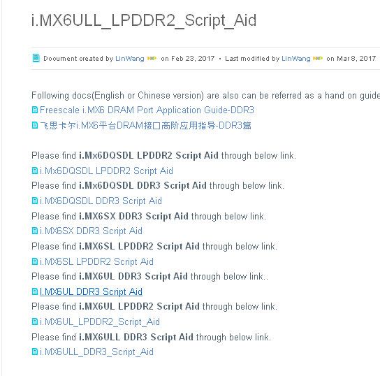

   I am using Solo board. This script aid looks like to be the one used for ultra lite. Can I use the same?

had you tried to open that link

anjalikkrishna
Hi Igor,
  Sorry for the confusion. Hope  second link is the the right one.
