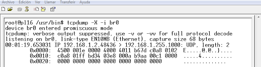

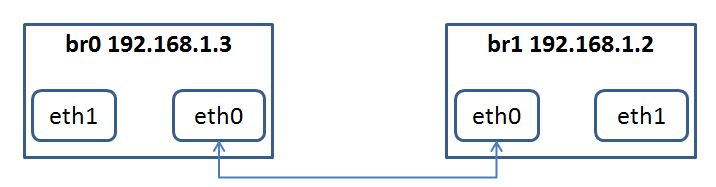

Hello
I have the next net.
I execute the tcpdump -X -i br0, with th next result.
but, When I execute my program to receive the mesage, I don't receive any messsage. My program is the next.

I can't find the error. Can anyone help me.
Thanks.

silviagonzalez
Hello
I did it, this is not my problem.
Now it works fine I resolved my problem, with the next code.
