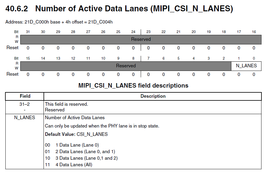

rogerio_silva
Hi Andrea,
Unfortunately not possible. Just the options below:
Rogerio

adc1
Hi Jamie,
I'm using "One lane mode", does it exist any configuration to let sensor use only lane 2?
for OV5640 register 0x4800 MIPI CTRL 00  Bit[3]: 0 Use lane1 as default data lane, 1 Use lane2 as default data lane
If I configure it to use lane2 as default I obtain a MIPI data error during transfer. Is it possible to use MIPI excluding first lane?
