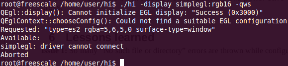

I am using Qt_Every_Where_OpenSource_4.7.4. on Ubuntu10.04LTS.
I am using Qt_Embedded for ARM. I have successfully built Qt for target.
Info about SimpleGL can be found here :: SimpleGL
I also have libqscreensimplegl.so in
<Qt_Every…..Source>/plugins/gfxdrivers/libqscreensimplegl.so
I ran make & sudo make install, but it is not available in the
/usr/local/Trolltech/Qt-target-version/plugins/
gfxdrivers directory itself is not present in the /usr/local/Troll…/…../plugins/ directory.
I am facing a problem when this is used on target.
How to get that ported onto target’s rootfs?
Please Suggest!
Thanks :: Krishna Pavan

I am using ltib 9.1.1 for i.MX51, BSP is 10.07.
I am using amd-gpu-bin-mx51.
From above screenshot, I see that QEgl is fine, but SimpleGL seems to be facing some problem.

Krishna Pavan said:
Hi Daniele,
This is what I am facing trouble with.
Please Suggest!
9,713 Views
KrishnaPavan
Hi Daniele,
Please Suggest!

Thing is that, I copy /usr/local/Trolltech/Qt-target-version to /ltib/rootfs/usr/local/Trolltech/ once I get everything in the /usr/local/Trolltech/Qt-target-version properly.
Difference is that you make a link, so that every change gets reflected as it is an when it is done.
I copy once everything is fine.
So, Procedurally, everything is proper, with you as well as me.
I have made a demo application and ran it on my board.
demo of fluidlauncher executed properly.
But my application requires simplegl, which is thrown as an error, that is when I recognised that it was missing in /plugins/gfxdrivers directory.
file_list_host is a list of files on my host
file_list_target is a list of files on my target
Where you can see that, liqscreensimplegl.so is present on Host but not on target.
9,708 Views

DanieleDall_Acq
Hi Krishna,
    Yes I know, I found this procedure for installing simplegl and quick3D, indeed :)
    The link I make at the begin plays the trick :) such that when you do make install
    anything that has to go under QT_targe_version  get copied  there.
    Give it a try and let me know.
      Ciao
            --daniele
Krishna Pavan said:
Thanks Daniele,
I have installed and I have target rootfs, I have also got SimpleGL plug-in.
But, As you can see, the library for SimpleGL is not present by default.
If you can check in <SourceDirectory>/src/plugins/gfxdrivers/ here you should have libqscreensimplegl.so, which is not available by default. Please check in your system.
Instead you should get it gone by downloading the code and prepare it.
By means of default procedure, I was able to get all the libraries, demos, examples for Target.
But simpleGL is something which I made using qmake & make.
SimpleGL library is now available in <qt_Source_directory./plugins/gfxdrivers/
But how to place it in /usr/local/TrollTech/Qt_target_version/plugins/gfxdrivers/ is what I could not understand at all.
Do you have libqscreensimplegl.so in /usr/local/TrollTech/Qt_target_version/plugins/gfxdrivers/ ?
Thanks & Regards :: Krishna Pavan

DanieleDall_Acq
Hi Krishna,
  I  compile QT application/Library outside ltib in this way, it was working also fro simplegl on my side, hope it will be the same for you:
[ ! -d /usr/local/Trolltech ] && sudo ln -s <full/path/to/your/rootfs/>/usr/local/Troltech /usr/local/Trolltech
(basically it checks the the link does not exist already and if does not it create it).
export PATH=$PATH:</full/path/to/crosscompiler/used/for/building/qt-4-i.MX>
Then in the directory of the applcaition library you want to build
/usr/local/Trolltech/qt-everywhere-opensource-src-4.7.4/bin/qmake
make
make  install (<-- this will probably sudo because it is the owner of the rootfs...)
Ciao
   --daniele
