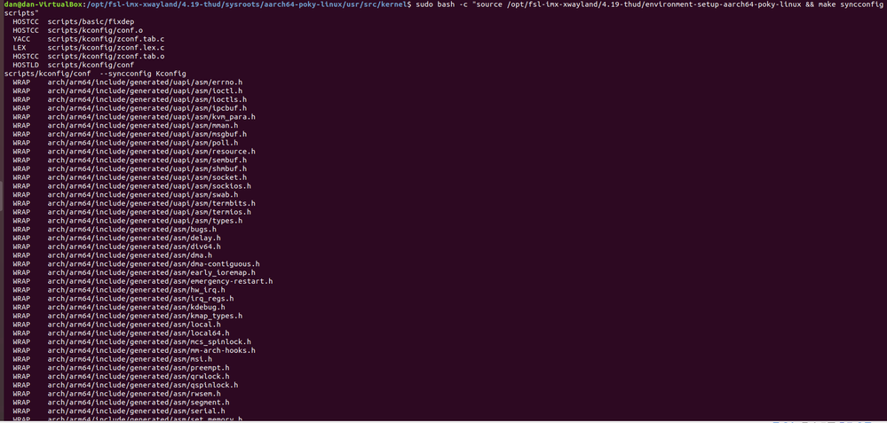

11,046件の閲覧回数
dan_hilgert
I was wrong and am not sure what @YuriF  was saying.
This is what I did to resolve the issue.
  1. Install Yocto SDK on host machine in default location
  2. cd <sdk-install-path>/sysroots/<mach>/usr/src/kernel
    • My specific machine was
      • cd /opt/fsl-imx-xwayland/4.19-thud/sysroots/aarch64-poky-linux/usr/src/kernel
  3. sudo bash -c "source /opt/fsl-imx-xwayland/4.19-thud/environment-setup-aarch64-poky-linux && make syncconfig scripts"
