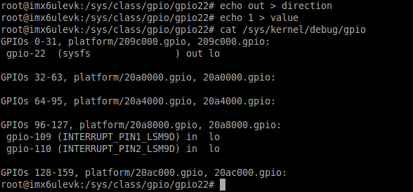

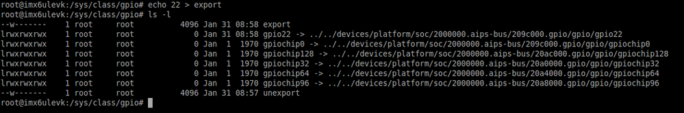

pastrana
Hi everybody,
I have a similar problem related with the topic talked it in this post. I am working with the imx6ul.
I want to change the value of the "MX6UL_PAD_CSI_DATA01__GPIO4_IO22". It means change it to low and high output value.
I included in my Device Tree the following lines:
        pinctrl-0 = <&pinctrl_hog_1>;
        imx6ul-ddr3-u15 {
                pinctrl_hog_1: hoggrp-1 {
                        fsl,pins = <
                                MX6UL_PAD_CSI_DATA01__GPIO4_IO22                0x4001b8b1
As you can see, I can add the gpio2 in the filesystem. However, as you can see in the next picture, it continues at low level:
Anyone know what could it happens??
Javier
33,680 Views
pastrana
Hi again,
I saw one mistake, i did not use this formula to map the gpio port:
linux gpio number = (gpio_bank - 1) * 32 + gpio_bit (reference)
It means the gpio port will be 118 = (4-1)*+22
However, it continues failing.
Any idea? thanks
Javier
33,680 Views
pastrana
I found the "mistake". It was working all the time. However, the "value" never changes. But, if I check the output with a voltmeter, it is working. Therefore, the problem is with the returned value.
To sum up, when the direction is "out" the software "value" is always 0. But, if i check the hardware pin, it changes.
Javier
33,680 Views
BiyongSUN
Please search the SION and  IOMUXC.SW_MUX_CTL_PAD_SD1_DATA1.SION=1 in the entire page to see if you can find the answer.
We have already given  a clear answer for output and explain what is SION in the previous answer.
Please double check if you have set the SION bit.
We have already given  a clear answer for output and explain what is SION.
Please double check if you have set the SION bit for the MX6UL_PAD_CSI_DATA01__GPIO4_IO22.
33,680 Views
pastrana
Thanks a lot, it is working!
The solution was:
Modifying the imx6ul-pinfunc.h and changing my used pin:
  • #define MX6UL_PAD_CSI_DATA01__GPIO4_IO22 0x01E8 0x0474 0x0000 0x15 0x0
This means SION bit = 1, and the 5 = ALT5
The changes must be done in imx6ul-14x14-evk.dts file:
BEFORE: MX6UL_PAD_CSI_DATA01__GPIO4_IO22                0x17059 (BIT SION NOT ACTIVATED)
AFTER:    MX6UL_PAD_CSI_DATA01__GPIO4_IO22                0x40017059 (BIT SION ACTIVATED)

BiyongSUN
Javier,
Your  code is not good enough, every time please don't modify  the headers.
In device tree for pinctl,  0x80000000 means   no pin config need
And 0x40000000 means  set SION .
So the correct change should be as following in imx6ul-14x14-evk.dts:
MX6UL_PAD_CSI_DATA01__GPIO4_IO22        0x40000000
Here is the test result:
Before set SION:
root@imx6ulevk:~# /unit_tests/memtool IOMUXC.SW_MUX_CTL_PAD_CSI_DATA01
SOC: i.MX6UL
IOMUXC   Addr:0x20e0000
  IOMUXC.SW_MUX_CTL_PAD_CSI_DATA01 Addr:0x020E01E8 Value:0x00000005 - SW_MUX_CTL Register
     IOMUXC.SW_MUX_CTL_PAD_CSI_DATA01.MUX_MODE(0..3)    :0x5
             Select 1 of 9 iomux modes to be used for pad: CSI_DATA01.
     IOMUXC.SW_MUX_CTL_PAD_CSI_DATA01.SION(4..4)        :0x0
             Force the selected mux mode Input path no matter of MUX_MODE functionality.

christophertele
there are different ways to access the gpios. you can access them from kernel- and userspace. in kernel space you have to use simple kernel modules. in user space you can toggle in bash using sysfs or in c using mmap and so on. here are some toggle speed results i get
Using sysfs (bash/c) [userspace]: ~3500Hz
calling /dev/mem using mmap [userspace]: ~800kHz
using gpio.h in a simple kernel module [kernelspace]: ~280kHz
ioremap() with writel [kernelspace] : ~1.6MHz
ioremap() with pointers [kernelspace]: ~5.5MHz
check out my code:
Dropbox - gpio_examples.tar.gz

christophertele
have you tried the other examples?check out the example "gpiotoggle.sh". just use the pin you want to toggle. that should work or you will get an error code during exporting the gpio.
what about gpioMod.c ?
this exmaple makes use of gpio.h. usage is very simple and the function gpio_request() should work or will give back an error.
this is how you calculate the GPIO Numbers:
linux gpio number = (<X> - 1) * 32 + <Y>
GPIO<X>_IO<Y> (example: GPIO3_IO23, X=3, Y=23)
cheers
christopher
