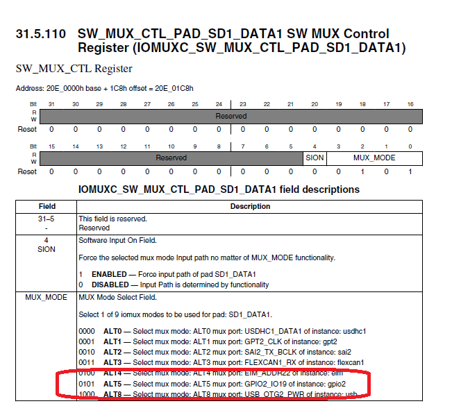

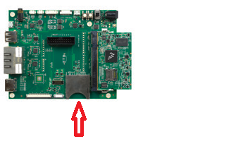

You don't have to re-compile  kernel(zImage). Just compile the dts file.
This is just for remove the GPIO from usdhc1.
II use the GPIO19, just want to introduce more linux development concepts and  technologies here.
For test purpose, you can just use the memtool. And choose which one is not used as GPIO in current dts.
root@imx6ulevk:~# /unit_tests/memtool IOMUXC.SW_MUX_CTL_PAD_SD1_DATA1.MUX_MODE=5
SOC: i.MX6UL
write 0x00000005 to Bit 0..3 of 0x020E01C8
root@imx6ulevk:~#
root@imx6ulevk:~# /unit_tests/memtool IOMUXC.SW_MUX_CTL_PAD_SD1_DATA1.SION=1
SOC: i.MX6UL
write 0x00000001 to Bit 4..4 of 0x020E01C8
root@imx6ulevk:~#
root@imx6ulevk:~#
root@imx6ulevk:~# echo 51 > /sys/class/gpio/export
root@imx6ulevk:~#
root@imx6ulevk:~# echo out  > /sys/class/gpio/gpio51/direction
root@imx6ulevk:~# cat /sys/kernel/debug/gpio
GPIOs 0-31, platform/209c000.gpio, 209c000.gpio:
gpio-3   (tsc_X-              ) in  hi
gpio-9   (VSD_3V3             ) out lo
gpio-19  (2190000.usdhc cd    ) in  hi
GPIOs 32-63, platform/20a0000.gpio, 20a0000.gpio:
gpio-51  (sysfs               ) out lo
GPIOs 64-95, platform/20a4000.gpio, 20a4000.gpio:
GPIOs 96-127, platform/20a8000.gpio, 20a8000.gpio:
gpio-119 (?                   ) out lo
GPIOs 128-159, platform/20ac000.gpio, 20ac000.gpio:
gpio-131 (?                   ) out lo
gpio-132 (headset detect      ) in  lo
gpio-135 (spi32766.0          ) out lo
gpio-136 (?                   ) out lo
gpio-138 (spi4.14             ) out lo
gpio-139 (spi4.14             ) out lo
GPIOs 248-255, spi/spi32766.0, 74hc595, can sleep:
root@imx6ulevk:~#
root@imx6ulevk:~# echo 1 > /sys/class/gpio/gpio51/value
root@imx6ulevk:~#
gpio-51  (sysfs               ) out hi
root@imx6ulevk:~#

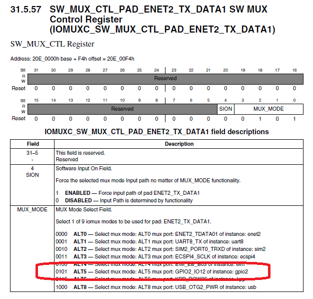

/unit_tests/memtool IOMUXC.SW_MUX_CTL_PAD_ENET2_TX_DATA1.MUX_M ODE=5
SOC: i.MX6UL
write 0x00000005 to Bit 0..3 of 0x020E00F4
root@imx6ulevk:~# /unit_tests/memtool IOMUXC.SW_MUX_CTL_PAD_ENET2_TX_DATA1.SION= 1
SOC: i.MX6UL
write 0x00000001 to Bit 4..4 of 0x020E00F4
root@imx6ulevk:~#
root@imx6ulevk:~#
root@imx6ulevk:~# echo 44 > /sys/class/gpio/export
root@imx6ulevk:~#
root@imx6ulevk:~# echo out  > /sys/class/gpio/gpio44/direction
gpio-44  (sysfs               ) out lo
root@imx6ulevk:~#
root@imx6ulevk:~# echo 1 > /sys/class/gpio/gpio44/value
root@imx6ulevk:~#
gpio-44  (sysfs               ) out hi
root@imx6ulevk:~#

I still can Not assign HI Outputs on the Development Pins on the IMX6 UltraLite Eval Board.
(Same for the Inputs, the Inputs are not recognized, just All LO.)
I modified/added to the Device Tree for my Imx6ul-14x14 Board:
~/yocto_3.14.38-6UL/tmp/work-shared/imx6ulevk/kernel-source/arch/arm/boot/dts #
  xemacs imx6ul-14x14-evk.dts &
&iomuxc {
pinctrl-names = "default";
pinctrl-0 = <&pinctrl_hog_1>;
imx6ul-evk {
  pinctrl_hog_1: hoggrp-1 {
   fsl,pins = <
    MX6UL_PAD_LCD_RESET__WDOG1_WDOG_ANY    0x30b0
    MX6UL_PAD_UART1_RTS_B__GPIO1_IO19 0x17059 /* SD1 CD */
    MX6UL_PAD_GPIO1_IO05__USDHC1_VSELECT 0x17059 /* SD1 VSELECT */
    MX6UL_PAD_GPIO1_IO09__GPIO1_IO09        0x17059 /* SD1 RESET */
     // MY PINS: //
     // MX6UL_PAD_UART1_RTS_B__GPIO1_IO19 0x17059 // SD1 CD //
     // cd-gpios = <&gpio1 19 GPIO_ACTIVE_LOW>;
      // UART2:
    // MX6UL_PAD_UART2_TX_DATA__UART2_DCE_TX 0x1b0b1
     MX6UL_PAD_UART2_TX_DATA__GPIO1_IO20 0x1b0b1
     // MX6UL_PAD_UART2_RX_DATA__UART2_DCE_RX 0x1b0b1
      MX6UL_PAD_UART2_RX_DATA__GPIO1_IO21 0x1b0b1
    // MX6UL_PAD_UART2_RTS_B__FLEXCAN2_RX 0x1b020
     MX6UL_PAD_UART2_RTS_B__GPIO1_IO23 0x1b020
    // MX6UL_PAD_UART2_CTS_B__FLEXCAN2_TX 0x1b020
     MX6UL_PAD_UART2_CTS_B__GPIO1_IO22 0x1b020
      // uSDhc1:
    // MX6UL_PAD_SD1_CMD__USDHC1_CMD 0x17059
     MX6UL_PAD_SD1_CMD__GPIO2_IO16      0x17059
    // MX6UL_PAD_SD1_CLK__USDHC1_CLK      0x10059
     MX6UL_PAD_SD1_CLK__GPIO2_IO17      0x10059
    // MX6UL_PAD_SD1_DATA0__USDHC1_DATA0  0x17059
     MX6UL_PAD_SD1_DATA0__GPIO2_IO18  0x17059
    // MX6UL_PAD_SD1_DATA1__USDHC1_DATA1  0x17059
     MX6UL_PAD_SD1_DATA1__GPIO2_IO19  0x17059
    // MX6UL_PAD_SD1_DATA2__USDHC1_DATA2  0x17059
     MX6UL_PAD_SD1_DATA2__GPIO2_IO20  0x17059
    // MX6UL_PAD_SD1_DATA3__USDHC1_DATA3 0x17059
     MX6UL_PAD_SD1_DATA3__GPIO2_IO21 0x17059
     // ENET2:
     //// MX6UL_PAD_ENET2_RX_EN__ENET2_RX_EN 0x1b0b0
    // MX6UL_PAD_ENET2_RX_ER__ENET2_RX_ER  0x1b0b0
     MX6UL_PAD_ENET2_RX_ER__GPIO2_IO15  0x1b0b0
     //// MX6UL_PAD_ENET2_RX_DATA0__ENET2_RDATA00 0x1b0b0
     //// MX6UL_PAD_ENET2_RX_DATA1__ENET2_RDATA01 0x1b0b0
    // MX6UL_PAD_ENET2_TX_EN__ENET2_TX_EN  0x1b0b0
     MX6UL_PAD_ENET2_TX_EN__GPIO2_IO13  0x1b0b0
     //// MX6UL_PAD_ENET2_TX_DATA0__ENET2_TDATA00 0x1b0b0
    // MX6UL_PAD_ENET2_TX_DATA1__ENET2_TDATA01 0x1b0b0
     MX6UL_PAD_ENET2_TX_DATA1__GPIO2_IO12  0x1b0b0
    // MX6UL_PAD_ENET2_TX_CLK__ENET2_REF_CLK2  0x4001b031
     MX6UL_PAD_ENET2_TX_CLK__GPIO2_IO14  0x4001b031
Next compiled :
  bitbake linux-imx -c compile -f
  bitbake core-image-minimal
Then Flashed and Booted.
And executed commands after login :
~/yocto_3.14.38-6UL/tmp/work/imx6ulevk-poky-linux-gnueabi/linux-imx/3.14.38-r0/image/boot #
echo 37 > /sys/class/gpio/export
echo "out" > /sys/class/gpio/gpio37/direction
echo 1 > /sys/class/gpio/gpio37/value
echo 38 > /sys/class/gpio/export
echo "out" > /sys/class/gpio/gpio38/direction
echo 1 > /sys/class/gpio/gpio38/value
echo 39 > /sys/class/gpio/export
echo "out" > /sys/class/gpio/gpio39/direction
echo 1 > /sys/class/gpio/gpio39/value
echo 40 > /sys/class/gpio/export
echo "out" > /sys/class/gpio/gpio40/direction
echo 1 > /sys/class/gpio/gpio40/value
echo 61 > /sys/class/gpio/export
echo "out" > /sys/class/gpio/gpio61/direction
echo 1 > /sys/class/gpio/gpio61/value
echo 62 > /sys/class/gpio/export
echo "out" > /sys/class/gpio/gpio62/direction
echo 1 > /sys/class/gpio/gpio62/value
echo 63 > /sys/class/gpio/export
echo "out" > /sys/class/gpio/gpio63/direction
echo 1 > /sys/class/gpio/gpio63/value
echo 64 > /sys/class/gpio/export
echo "out" > /sys/class/gpio/gpio64/direction
echo 1 > /sys/class/gpio/gpio64/value
gpio-37  (sysfs               ) out lo
gpio-38  (sysfs               ) out hi
gpio-39  (sysfs               ) out lo
gpio-40  (sysfs               ) out lo
gpio-61  (sysfs               ) out lo
gpio-62  (sysfs               ) out lo
gpio-63  (sysfs               ) out lo
gpio-64  (sysfs               ) out lo
gpio-111 (sysfs               ) out lo
gpio-112 (sysfs               ) out lo
gpio-113 (sysfs               ) out lo
gpio-114 (sysfs               ) out lo
gpio-115 (sysfs               ) out lo
gpio-116 (sysfs               ) out lo
Notice that the Cat Sys Debug still shows LOWs for ALL the Outputs ?
(while Gpio1.38 flickers between HI and LO)
What am I missing ?
14,655 Views
