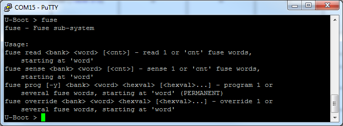

I want to to this manipulation by two ways :
  • A JTAG debugger
  • The u-boot user interface with the command "fuse"
On the SabreLite I've no problem:
  1. I read the value of OCOTP_SRK0 register : 0x0000_0000
  2. I write a value on it : 0x0011_2233
  3. I read its value again : 0x0011_2233
  4. Write '1' in OCOTP_OCTRL[10] in order to reload register
  5. And then when I read OCOTP_SRK0 I've the reinitialized value : 0x0000_0000
Everything are well, by the JTAG or by the u-boot. Even, I can mix the JTAG and u-boot manipulation, when I modify on one, the other stay coherent with the modification.
On the RIoTboard, and here is the problem, when I want to proceed the same manipulation I can't.
  1. I can read the value of  OCOTP_SRK0 register : 0x0000_0000.
  2. But I can't write on it and so overwrite with the value 0x0011_2233
  3. It seems  can't also write on the OCOTP_OCTRL[10]. (I'm not sure because I can't change any value so I can't check if I can't reload it).

Firstly I thought I can't write the shadow fuses because the OCOTP_LOCK is not configured as on the SabreLite.
BUT, on the both board this register has the same value ... So I start to read in detail the features of each fuse in order to understand what stops me to write some shadow registers.
Because it's a long, complicated work and I'm not sure to succeed, I ask the question here.
Q: Does someone have an idea about why I can't proceed the the manipulation as the SabreLite on the RIoTboard ?? Does the problem come from the fuses ?
Don't hesitate to ask me more information,
Thank you for your help.
Fabien.

   Perhaps the problem relates to different U-boot versions for
the SabreLite and  the RIoTboard. Please try using  recent NXP
U-boot  version.
Yuri

fmajeric
Thank you for your answer.
I will try it as soon as possible.
I think you are right because the last time I want to use the CAAM through its registers but I can with JTAG.
Then I change the U-boot and the CAAM registers were mapped in the RAM memory.
I come back to give the result.
