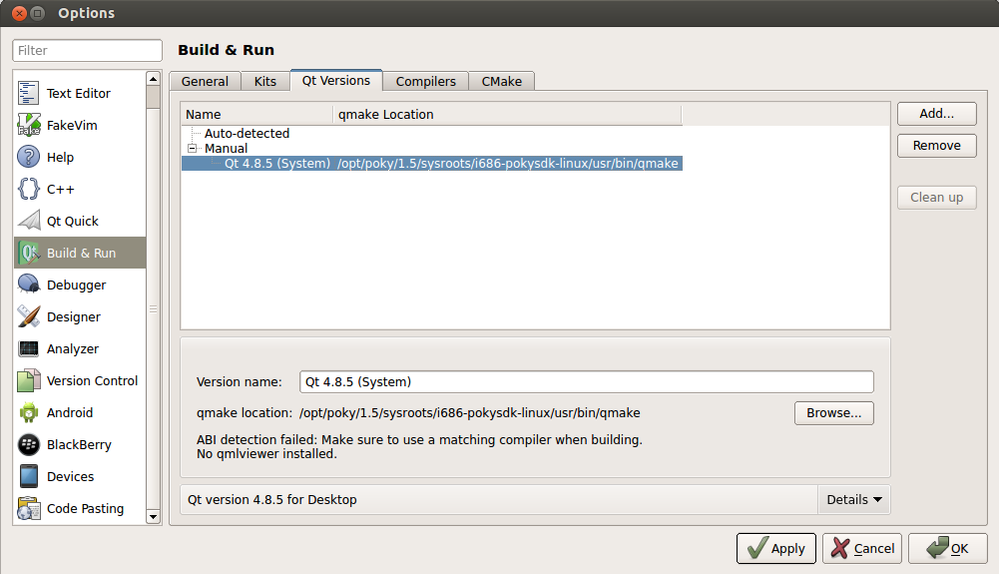

Hi Joreg / Everybody,
I follow the same exact step as mentioned above (with same version of QT creator) ,
but I endup getting ABI detection failed in QT version tab ( i selected qmake2) and it throws exception
I tried clean install many times, but each time its the same.
Any input  on this regard will be highly appreciated.
29,015 Views
Joerg-SH
Hello Jay,
thats "normal" should work properly with that!
If not than should be the mistake on an other place.
regards
Joerg
29,015 Views

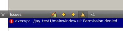

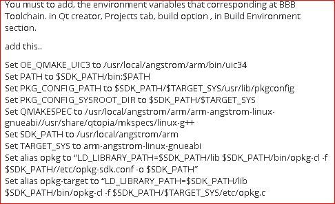

jayrao
Hi Joreg,
Now I stumble on this when I try to build  (QT creator 2.8)
The below thread indicated that the follwing env variables has to be set
http://qt-project.org/forums/viewthread/29456
Joreg, do you happen to know if its necessary to add variables in the project build option ?
Thank you .
29,015 Views
Joerg-SH
There is no need to do that
only
edit the bin/qtcreator.sh
source /opt/poky/1.4.1/environment-setup-armv7a-vfp-neon-poky-linux-gnueabi
#! /bin/sh
and start i with it
29,015 Views
