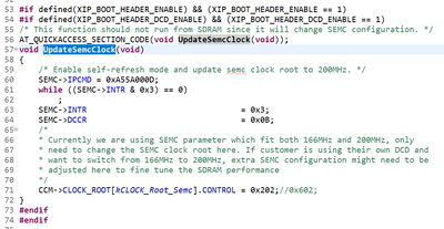

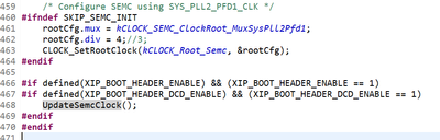

Currently, we use the i.mxRT1172 for LCD project. I use emwin for SDK example code.
As I know SDK's emwin project setting the max SDRAM bandwidth of RT1170 is 200x2 = 400 MB/s,
However, we need to change the clock from SDRAM setting form 200MHz to 166MH, base on our SDRAM's spec.
Could you provide the example for 166MHz SDRAM or clearfy why I am unable to reduce the SDRAM clock?
The following is my dcd setting

And I also have another testing for clock_config.c
Just wanna SDRAM clock get any change..

Firstly, assume you use the DCD to initialize the SDRAM, it's unnecessary to update the clock of SEMC actually.
Next, back to your below question,
1) Could you provide the example for 166MHz SDRAM or clearfy why I am unable to reduce the SDRAM clock?
-- I'd like to suggest you to modify the semc which resides in the ~\boards\evkmimxrt1170\driver_examples\semc to implement access the SDRAM on your board, after that, you can adjust the DCD by referring to the detailed values of the SEMC's registers.
TIC
TIC
