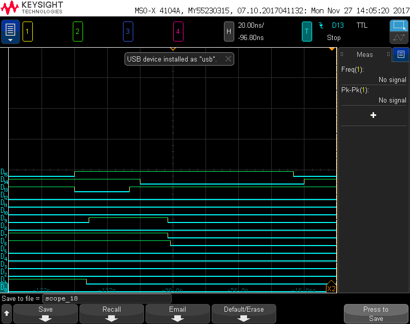

I'm using a 7D board with a EIM interface to an FPGA. I have this working well with 6sl using 66MHz clock. On 7d, I tried to setup the 66MHz clock using devicetree as per below:

The processing of that looks fine. I dumped the EIM_CS3/4 regs and they match the configuration values specified above. When I access the memory space, I get CS assertion and the transaction (aside from exact timing) looks reasonable.
The part that does not seem to work is the assigned-clock-rate. I've specified 66MHz above. But it does not seem to have any effect on the physical interface. Here's the timing that I get:
D15 is the chipselect. D11-D0 are address lines.
The total chipselect assertion time is only 65ns which is only 4 clocks at 66MHz! It should be about 350ns (which is what it is on 6sl).
Signals like LBA and Address phase seem out of sync (LBA gets asserted before address seems to be valid). This leads to me think that the core EIM clock is wrong.

4,294 Views
art
Actually, the EIM root clock selection setting seems to be wrong. Try to dump the EIM clock root slice register at the 0x3038A980 address and check its value. Typically, it should be either 1 (SYS_PLL_PFD2_DIV2 running at 135MHz as the root clock source), 2 (SYS_PLL_DIV4 running at 120MHz as the root clock source) or 6 (ENET_PLL_DIV8 running at 125MHz as the root clock source). The maximum EIM root clock frequency must not exceed 135MHz for the i.MX7Dual processor.

4,294 Views
art
Seems not to be supported in device tree. Better seems to set the register manually.

jayakumar2
Contributor V
Hi Artur,
Thanks for your reply. I'm not sure it is 'better' but since seems like nobody will fix it in devicetree or imx-weim code, then I have no choice but to set it manually.
However, even when I set it manually, ie: by seting POST_PODF=1 , 0x3038A980: 12000001 , now EIM clock should be 60MHz (120/2), I still get bad behavior from the EIM signals. For example, the address signal AD14 (D1 in scope) and AD6 (D9 in scope) change late (7.5ns and 10ns) after EIM_LBA (D13 in scope) is already asserted. This results in FPGA latching wrong address since it has to use LBA as the address valid signal.
I checked that on 6sl, using the exact same EIM register settings, I do not get this behavior and AD signals change before LBA assertion. So it seems to be some problem specific to 7d. Here's my EIM register settings:
