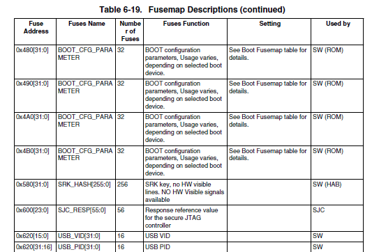

Not 100% sure on this, but I assume you mean a way to program a USB PID and VID code?
If so then there are areas in the fuse map assigned for this, see the reference manual -
These are intended for customer use, what I'm not sure about is if there is a direct link between these fuse values and the serial loader mode, but I think it is likely, you can try programming a test value to see if it works as required, but for production I think you would need to be using registered VID and PID codes with the usb.org.
