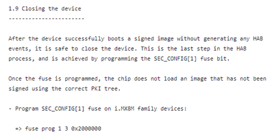

I used my i.MX8MQ custom board to develop secure boot by following this document [mx8m_secure_boot.txt] . After I program SEC_CONFIG[1] fuse on devices, it cannot boot up.
Is there anything wrong?

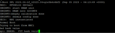

There is problem with SPL verify hash.
Have you run hab_status to verify your signing imge before close the device?
Can you share how you sign, csf files?

hab_status :

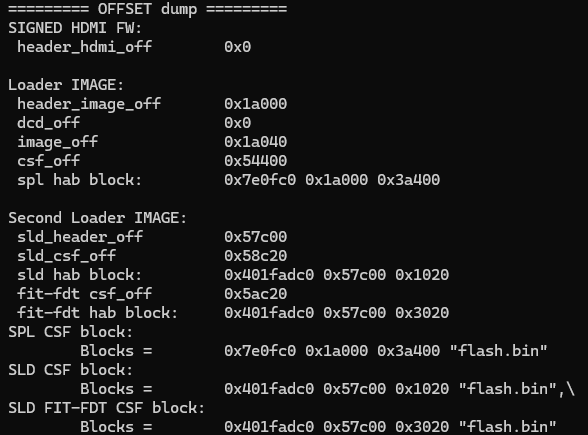

flash.bin build log:
print_fit_hab build log:
csf_spl.txt:
[Header]
    Version = 4.3
    Hash Algorithm = sha256
    Engine = CAAM
    Engine Configuration = 0
    Certificate Format = X509
    Signature Format = CMS
[Install SRK]
    # Index of the key location in the SRK table to be installed
    File = "../../crts/SRK_1_2_3_4_table.bin"
    Source index = 0
[Install CSFK]
    # Key used to authenticate the CSF data
    File = "../../crts/CSF1_1_sha256_2048_65537_v3_usr_crt.pem"
[Authenticate CSF]
[Unlock]
    # Leave Job Ring and DECO master ID registers Unlocked
    Engine = CAAM
    Features = MID
[Install Key]
    # Key slot index used to authenticate the key to be installed
    Verification index = 0
    # Target key slot in HAB key store where key will be installed
    Target index = 2
    # Key to install
    File = "../../crts/IMG1_1_sha256_2048_65537_v3_usr_crt.pem"
[Authenticate Data]
    # Key slot index used to authenticate the image data
    Verification index = 2
    # Authenticate Start Address, Offset, Length and file
    Blocks = 0x7e0fc0 0x1a000 0x3a400 "flash.bin"
csf_fit.txt:
[Header]
    Version = 4.3
    Engine = CAAM
[Install SRK]
    Source index = 0
[Install CSFK]
[Authenticate CSF]
[Install Key]
    Target index = 2
    # Key to install
[Authenticate Data]
    Blocks = 0x401fadc0 0x057c00 0x001020 "flash.bin", \
             0x40200000 0x05CC00 0x10ECB0 "flash.bin", \
             0x4030ECB0 0x16B8B0 0x00DF60 "flash.bin", \
             0x00910000 0x179810 0x00A0E0 "flash.bin", \
             0xFE000000 0x1838F0 0x08A350 "flash.bin"
