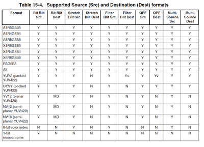

Processor is i.MX 8M Plus, additionaly table on page 6 is saying that SRC(G2D_YUYV) / DST(G2D_NV12) conversion is possible Y(*).

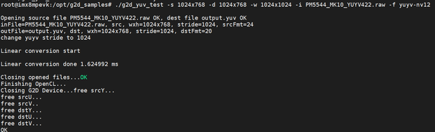

~/g2d_samples# ./g2d_yuv_test --format yuyv-nv12 --source 1920x1080 --wh 1920x1080 --dest 1280x720 videotest_1920_1080_YUY2.raw
Segmentation fault
where videotest_1920_1080_YUY2.raw file was generated by using gst-launch
gst-launch-1.0 --verbose videotestsrc num-buffers=1 ! video/x-raw,format=YUY2,width=1920,height=1080,framerate=1/1 ! videoconvert ! video/x-raw,format=YUY2,width=1920,height=1080,framerate=1/1 ! filesink location=videotest_1920_1080_YUY2.raw
4,039 Views

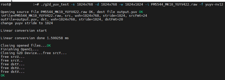

joanxie
it seems the command you used isn't correct, I tested successfully, try to refer to my command
3,957 Views
marcinch
I use the same command and input file as you indicated in your replay and it works!
  • yuyv (1024x768) -> nv12 (1024x768)
I created new raw file with 1920x1080 resolution using ffmpeg tool and I called once again g2d_ yuv_test, and it also works!
  • yuyv (1920x1080) -> nv12 (1920x1080)
The last scenario when I want to change the output format and size simultaneously shows error messages.
  • yuyv (1920x1080) -> nv12 (1280x720)

joanxie
try to set -w 1920x1280

refer to the reference manual, yuv dst resizing doesn't supported by the imx8mp g2d
