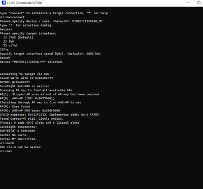

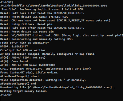

On our customized board based on EVK RT1176_AA. We run into an unusual behavior for SWD debugging.
Our processor is RT1172_8A. We don’t use QSPI flash. Debugger is Segger Jlink Pluse. Speed is auto or 4000kHz.
I used Jlink commander and I found out that on the first connection I cant HALT the CPU but if I reconnect during the same session then try to HALT everything seems ok. This could be the reason for the error when I debug from MCUxpresso.
Any idea on what can be the cause for such behavior?

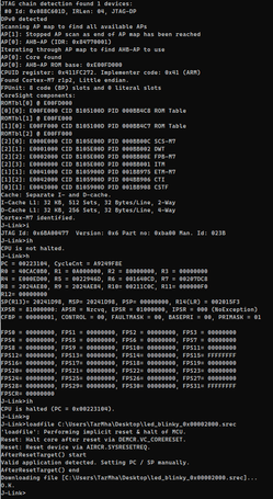

It is caused by Debug Mailbox, when soft reset is issued under Non-XIP boot mode, PC will always be stuck in 0x223104
https://www.cnblogs.com/henjay724/p/15725966.html

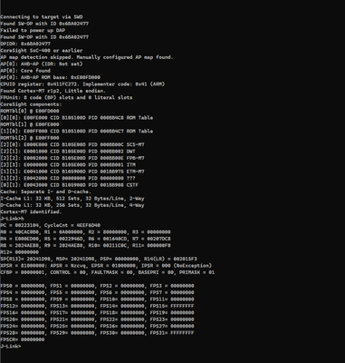

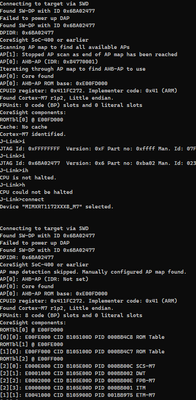

It is strange that I am able to debug using JTAG (SWD didn't work) from mcuxpresso despite this issue, however the program doesn't seem to be executing (no blinking or change).
Going back to the problem, I read the article about this issue, I think the issue as you mentioned. PC is halted at 0x00223104 (both SWD Jtag) .
I don't know why I can load a nonXIP file using JTAG but no blinking after execution.
I attached the complete SWD and JTAG steps below. How to solve this issue since I don't have a QSPI flash on my board ?
Jtag:
SWD:

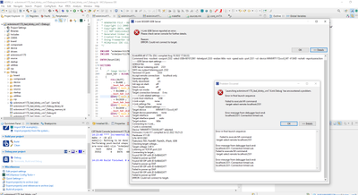

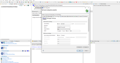

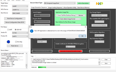

This thread was created by me. I was able to verify the board with the Blinky example 0x00002000.src from Mcubootutility apps file.
Now I a trying to generate my .s19 file from mcuxpresso. I followed this link to modify the code to work with SEMC NAND
https://www.cnblogs.com/henjay724/p/12591382.html
As you can see from picture I still get an error even after changing the vector table starting address.
If I choose to link the program to RAM from properties I get a different error.
when linked to RAM
