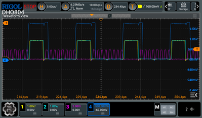

Greetings,
I’m currently trying to communicate between the i.MX 8M Plus and some module via SPI. However, I’m seeing that the chip-select line toggles on each byte transfer, when it should stay low for the entire transaction for the command and its arguments. Is this the default behavior? If so, how can I keep CS asserted throughout the whole communication? Also, what's the default SPI_MODE in terms of phase and polarity of the clock ?

Hi @Baha_Yenioglu!
Thank you for reaching out to NXP Support!
Could you please share your device tree configuration?
I've encountered similar behavior before when the configuration doesn't follow the structure shown in the example below:

After I applied this structure to my dts, CS stayed stay low for the entire transaction.
