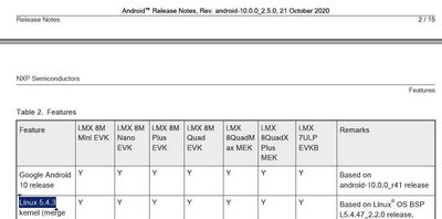

igorpadykov
for Android it is the same as it is based on Linux, for example for Android 10 2.5.0 it is L5.4.47_2.2.0 :
igor
