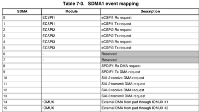

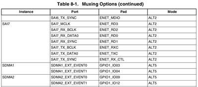

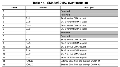

About GPIO:
Cupcake_0-1684833235565.pngCupcake_0-1684833235565.pngCupcake_1-1684833277424.pngCupcake_1-1684833277424.pngCupcake_2-1684833302937.pngCupcake_2-1684833302937.png
The specs are really not clear, about what is "External DMA from pad through IOMUX" and if it is related with "SDMAx_EXT_EVENTn" and if we can trigger a DMA channel with it... But as I understand it's possible.
So if my understanding is correct, we can trigger a SDMA channel with GPIO.

GPIO:
It is definitely not possible to trigger the SDMA from the GPIO peripherals. But you may use the SDMAx_EXT_EVENTn lines (using them as SDMA peripheral input, not as GPIO). But you may run into the same problem that you may not be able to distinguish between rising/falling edge in this case (assuming that you can choose the active edge, maybe that's not possible for SDMA event intputs). This could eventually be fixed by reading the GPIO line state after the SDMA has been triggered, but this is a little bit racy.

1. Connecting a SDMAx_EXT_EVENTn to the radio signal, and another GPIO to the same radio signal
2. In the DMA process, if it can be triggered by both edges on SDMAx_EXT_EVENTn, then read the GPIO to know the "level"
About the second method, the specifications are really not clear. Did you know what are the possible triggers for DMA with a SDMAx_EXT_EVENTn pin ? Where is it explained in the reference manual ?
I don't find any mentions about what we can do with this, for exemple can we trigger on falling edge, rising edge, both ?
I understand that SDMAx_EXT_EVENTn is not GPIO, but where is it explained what it is ?

I use the GPT INPUT_CAPTURE events with the SDMA. The documentation may be not precise here.
I also haven't found any documentation about the polarity of the SDMA event lines (I also haven't used them yet). So it's likely that you can NOT use them for triggering on both edges.
