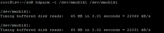

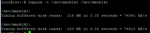

And now, the behaviour:
1- When sd card is inserted, it seems correct:
2- Then hdparm gives an expected reading rate value (>70 Mo/s):

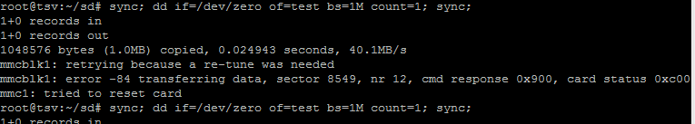

3- But when accessed in writing:
4- And after, the reading rate has dropped:

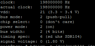

 Well, these links are interesting, so i checked a lot of relevant points without success.
And, i try to tune drive strength. It appears that current settings are good, since when i move towards higer impedances, SD card is no more detected.
With current settings, i have:
So clock is at 198 MHz (i'm surprised it be not 208 MHz as specified in SDR104 mode), voltage is at 1,8 V and SD card is detected.

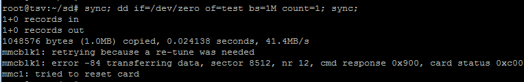

But when writing:
This error occurs only one time, but it makes regress the SD speed, since after:
SD card is no more in SDR104 mode. The only way to resume it seems to eject and insert it again.
