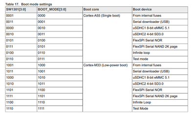

Hi team,
         I'm trying to bring-up the custom board using  boot from uSDHC 4-bit SD 3.0 in Single boot mode on my imx-93  custom board. I checked boot modes which are configured correctly. But unable to boot. Please do the needful. Can I boot from Serial downloader for testing purpose.
Can you guide me steps to boot from on-Chip RAM using USB.
Robbi
770 Views
JorgeCas
To boot from serial download mode you need to change boot mode pins, if you are not able to change this, the boot flow will jump to serial download mode if there is no a bootable image in selected boot source.

Robbi
Thanks @JorgeCas ,
                            After changing the settings of Boot Mode in below Table.
I had gone through section 9.3.4 section Serial Downloader Mode  in Reference Manual.
can you brief what operation does program Image  to chip does.
Thanks Robbi.
745 Views
JorgeCas
You need to use the second option.
