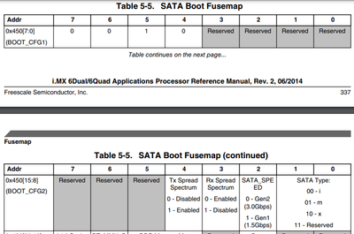

Attempt to boot SATA based on sd boot.
Checking according to the value specified in 'iMX 6Dual/6Quad Applications Processor Reference Manual', I understand that setting the value of BOOT_CFG1 [7:0] to 00100000.
However, it is ambiguous to set the value of BOOT_CFG2 [7:0]. Should I set the value of BOOT_CFG2 [7:0] to 00000000?
Thank you!

Yes, you can set it, please see details in our RM:
