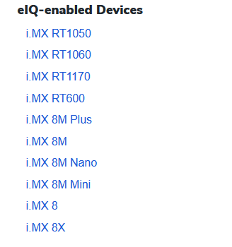

I added and tested tensorflow-lite in Yocto for i.mx6sx. The meta-ml packages were needed during the compilation process, but the compilation failed.
2,242 Views
weidong_sun
Yes, only i.mx8 serials processor support eIQ and machine learning. See below, please!
https://www.nxp.com/design/software/development-software/eiq-ml-development-environment:EIQ
Have a  nice day!
