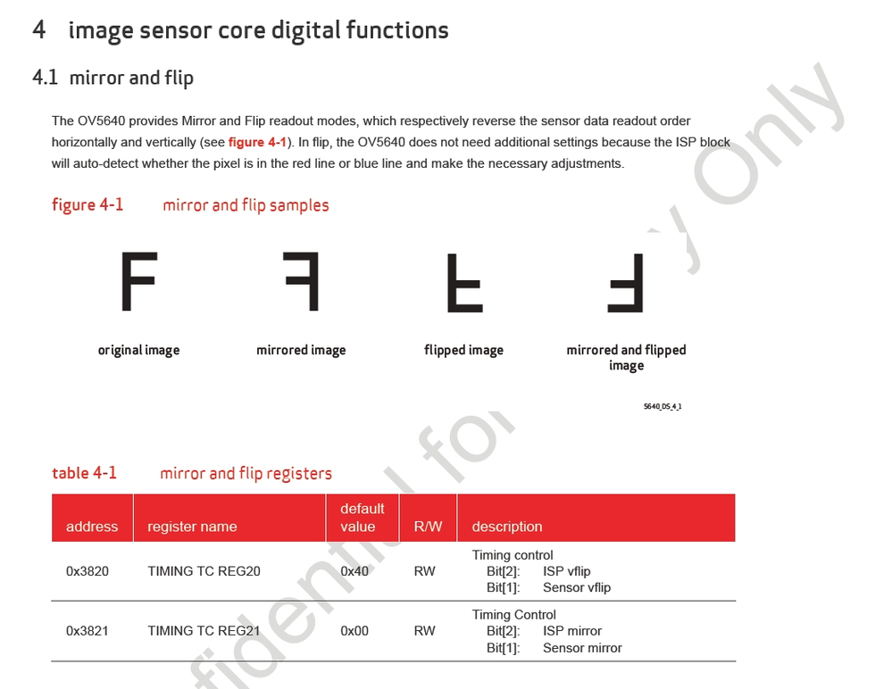

weidong_sun
Hello,John,
      Hope this message could help you ! I have tested it !  See following :
Weidong

letan
Hello Weidong,
Could you please tell me how we can rotate 180?
I did as below but it doesn't work
{0x3820, 0x47, 0, 0}, {0x3821, 0x01, 0, 0}, {0x3814, 0x31, 0, 0},
Tan

john_ortega
hi weidong,
i think this is not the one i need since i need to rotate the video (by 90 degrees) and not flip or mirror.
thanks,
john
