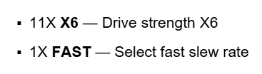

Zhiming_Liu
Hi @adithya369
Please use below setting about pad configuration.
The test code should like this:
Zhiming

adithya369
From your advise to explicitly set the slew rate for pad configuration using the following macro:
#define GPIO_CONFIG ( \
IOMUXC_SW_PAD_CTL_PAD_PE(1U) | /* Pull Enable */ \
IOMUXC_SW_PAD_CTL_PAD_PUE(1U) | /* Pull Up */ \
IOMUXC_SW_PAD_CTL_PAD_DSE(3U) | /* Drive Strength = medium */ \
IOMUXC_SW_PAD_CTL_PAD_FSEL(1U)| /* Function select = 1 */ \
IOMUXC_SW_PAD_CTL_PAD_SRE(1U) /* Fast slew rate */ \
However, after adding the IOMUXC_SW_PAD_CTL_PAD_SRE(1U) line, I get the following build error:
error: implicit declaration of function 'IOMUXC_SW_PAD_CTL_PAD_SRE'; did you mean 'IOMUXC_SW_PAD_CTL_PAD_ODE'? [-Wimplicit-function-declaration]
My Questions:
Is IOMUXC_SW_PAD_CTL_PAD_SRE missing or not defined in this SDK?
What is the correct way to set slew rate for a GPIO pin on this platform?
Could this be a header file or SoC support issue?
I followed the recommended approach, but now I’m stuck due to this build failure. Any help or clarification would be appreciated.
Thanks and regards,
Adithya.

Zhiming_Liu
Please use IOMUXC_SW_PAD_CTL_PAD_FSEL
#define IOMUXC_SW_PAD_CTL_PAD_FSEL_MASK          (0x18U)
#define IOMUXC_SW_PAD_CTL_PAD_FSEL_SHIFT         (3U)
/*! FSEL - Slew Rate Field
 *  0b0x..Select slow slew rate (SR=1)
 *  0b1x..Select fast slew rate (SR=0)
#define IOMUXC_SW_PAD_CTL_PAD_FSEL(x)            (((uint32_t)(((uint32_t)(x)) << IOMUXC_SW_PAD_CTL_PAD_FSEL_SHIFT)) & IOMUXC_SW_PAD_CTL_PAD_FSEL_MASK)
Zhiming

adithya369
Hi @Zhiming,
Thanks for the response.
IOMUXC_SW_PAD_CTL_PAD_DSE(6U) | \
IOMUXC_SW_PAD_CTL_PAD_HYS_MASK | \
IOMUXC_SW_PAD_CTL_PAD_PE_MASK | \
IOMUXC_SW_PAD_CTL_PAD_PUE_MASK | \
added this config
IOMUXC_SetPinConfig(IOMUXC_SAI1_RXD1_GPIO4_IO03, GPIO_CONFIG); // add0
but still the toggling speed is not changed
