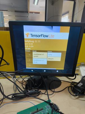

mohamed_gaseen
The default application (android.example.com.tflitecamerademo) runs successfully on the Android 14 BSP and primarily performs image classification. However, we require a face recognition demo application to run on the same BSP.
Could you please confirm whether NNAPI is equivalent to the NPU?
We observed a latency of 200 ms when using the CPU, whereas NNAPI achieves 12 ms.
7,154 Views
Bio_TICFSL
NNAPI is Neural Network API de android, This API use components of GPU and NPU.

mohamed_gaseen
Thank you @Bio_TICFSL for your prompt response and for confirming NNAPI support on the i.MX8MP platform.
As a next step, I am looking for a face recognition example implemented in Android code, preferably utilizing NNAPI delegates to run on the NPU. While I have reviewed the Python-based examples provided in the eIQ documentation, I would appreciate a native Android application—similar to TensorFlow Lite Android examples—but tailored for face recognition.
Also could you please reply to these two points:
  • Do you have any VIT voice recognition running model on Android ?
  • Can you please find the attached image, here we're selecting NNAPI which is both GPU & NPU supported as you referred. But I want to specify only for GPU. Is there any possible way ?
Kindly share a reference implementation or point me to any existing Android project that demonstrates face detection or recognition on i.MX8MP using NNAPI?
