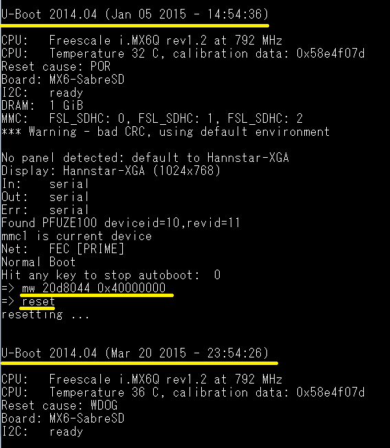

BiyongSUN
1. Create SDCARD:
   dd if=i.MX6Q-secondary_boot_demo.sdcard of=/dev/sdc bs=512 skip=1 seek=1
2. Turn on Secondary Boot:
   In the uboot commandline:
type:    mw 20d8044 0x40000000
type:    reset
Demo Screenshot:
