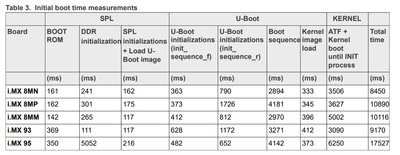

I use a IMX 93 card
i see in the first panel that the total boot time for this card is 9170 ms
My boot time is about 20000 ms (20 sec) even with a kernel build as "core minimal"
How is built the kernel to obtain a 9170 ms boot time ?

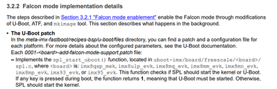

I was using Yocto Real Time Edge 3.1
Now I'm using Falcon: Yocto Project BSP 6.6.23_2.0.0 Release
At Falcon startup, I get:
Trying to boot from EMMC2
for about 45 seconds
How can I eliminate this delay?
Greetings
Olivier
4,422 Views
Manuel_Salas
Hello @OlivierG
Please double check if you followed the below step from the application note:
Best regrads,
Salas.
4,408 Views
OlivierG
hi
This patch was automatically apply by bitbake, i verify this in the C files
i must precise that the kernel is on a SD card not in eMMC memory
Greetings
Olivier
