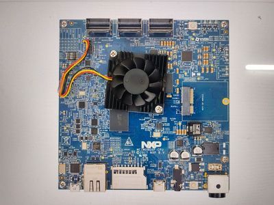

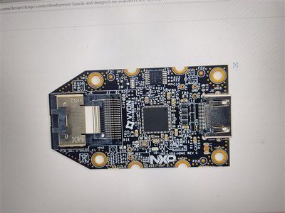

subbuemdtest
Hi @Zhiming_Liu ,
We have done a custom Yocto build using this guide: (https://www.nxp.com/docs/en/user-guide/IMX_YOCTO_PROJECT_USERS_GUIDE.pdf).
We are trying to enable the "i.MX 8QuadXPlus Multisensory Enablement Kit (MEK)" (https://www.nxp.com/design/design-center/development-boards-and-designs/i-mx-evaluation-and-developm...)
using the Yocto custom image (linux-imx), and we are trying to interface an LVDS to HDMI converter from NXP (https://www.nxp.com/part/IMX-LVDS-HDMI).
We are unable to view the HDMI port in the Linux device tree. How do we enable it?
Provide the exact steps to be done clearly.
kindly provide your support.
