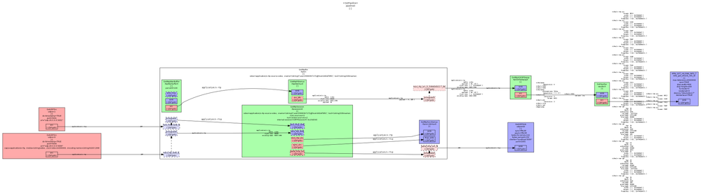

ottoblom
Still no luck getting this working properly. With what BSP version was this tested ?  I attached the pipeline diagram below
Thanks in advance
/Otto
