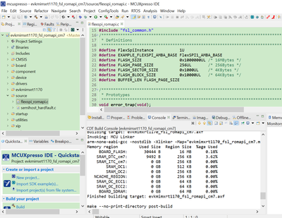

Hi there,
just looking at the RT1170 EVK FSL ROM API CM7 Example... MCUXpresso 11.4, SDK 2.10

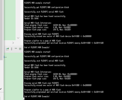

Built and debugged the project fine; it was able to successfully identify and erase/program the NOR Flash.
I'm creating a bootloader and am looking at this as the starting point; I was hoping to execute out of ITCM, to ensure that there are no issues accessing NOR (XIP) while it is being programmed.

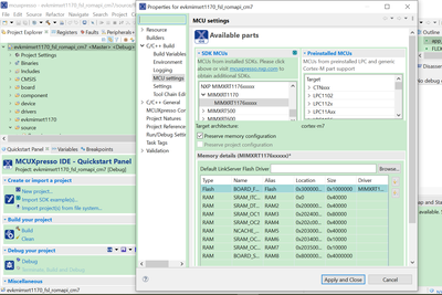

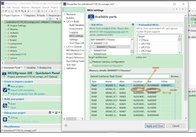

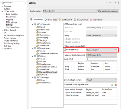

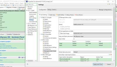

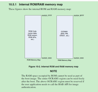

I made a couple minor changes to the project: in the linker options I specified "Plain load image" with SRAM_ITC_cm7; I removed OCRAM1 region from memory configuration since it overlaps with the ROM memory.

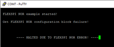

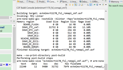

After this change, I can build and debug the project, and code is placed in ITCM correctly; however, the ROM_FLEXSPI_NorFlash_x() functions now fail with kStatus_InvalidArgument.

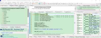

Unfortunately I can't step through the ROM code to figure out what's wrong...
Thought that it might be something to do with the FLEXSPI clock (serial_nor_config_option_t max_freq), but was wondering if anyone knew off the top of their head?
My assumption is that since the code was loaded from NOR to SRAM by ROM the FLEXSPI is set up correctly, but maybe detecting that the load/exec addresses aren't the same is bypassing this?
Thanks for the help,
Matt

  As your used item: plain load image, it is not for RT, it is for the LPC series.
Please check the IDE install path document:
C:\nxp\MCUXpressoIDE_11.4.0_6157_prc1\MCUXpresso_IDE_User_Guide.pdf
page 189, chpater 17.8.4 Plain Load Image.
You will find it is desiged for the LPC540XX series, not for RT.
RT 1170 and LPC are totally different.

I was able to get the example running from ITCM when using the "Link application to RAM" option instead of the "Plain load image" option.
I do have the part set correctly for the i.mx rt1170 dev (MIMXRT1176xxxxx in the MCUXpresso MCU Settings), and the "Plain load image" option is always available for me even though I'm not using an LPCx.

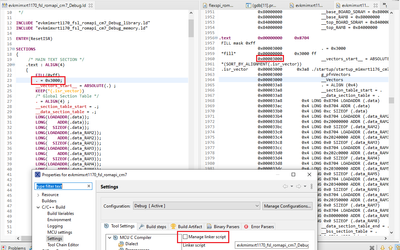

I deselected "Manage linker script" and added the following vector table offset as suggested:

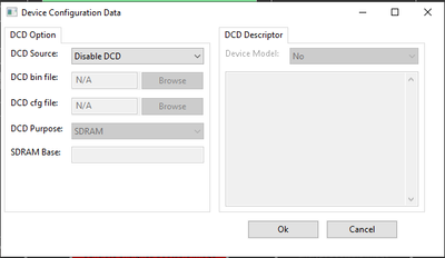

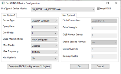

I configured the target as follows:
Boot Device Configuration:
DCD Configuration (none, just using internal SRAM):
I also set the IVT Entry Type:

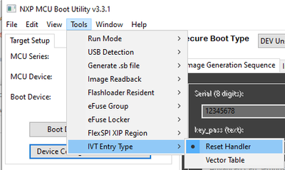

I connected to the EVK and selected the MCUXpresso output file; when I select "Generate Unsigned Bootable Image" I get the following error:
I tried to change the Tools -> IVT Entry Type to be "Reset Handler" and "Vector Table" but the result is the same.
In all cases I tried the resulting srec does not have any boot headers added.

  • RAM application is linked in ITCM at offset 0x0000_2000
    • I chose 0x2000 instead of 0x3000 as the offset.
      • Why is this offset needed?

Please also note, you need to modify the memory offset to at least 0x2000.

When using this configuration, ROM_FLEXSPI_NorFlash_GetConfig() fails:
