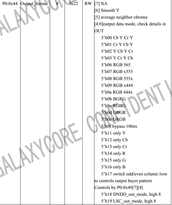

I use pxp convert image by YUV422 to RGB565, YUV422 from camera ,so we set psBufferConfig.pixelFormat the value has

the camera parameter only  have  YCbCr 422.
So I should choose which one.

Please help to provide the camera datasheet.
Then we can select the correct ps buffer format.

shawn_chai
GC0328 Datasheet
The value I assign to the 0x44 register is 0x22,Please help me,thansssssssssssss!!!!!!!

Hui_Ma
Thank you for the info.
Please select below format value:
kPXP_PsPixelFormatUYVY1P422 = 0x12, /*!< 16-bit pixels (1-plane U0,Y0,V0,Y1 interleaved bytes) */
Wish it helps.
