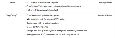

You can try to change vdev0vring and vdevbuffer to SSRAM instead of DRAM.
As you can see on reference manual, DRAM is clock gated on deep sleep mode:
In the device tree of i.mx8ulp you can see those are configured in DRAM:
Manuel_Salas_1-1756950780006.pngManuel_Salas_1-1756950780006.pngManuel_Salas_2-1756950795515.pngManuel_Salas_2-1756950795515.png

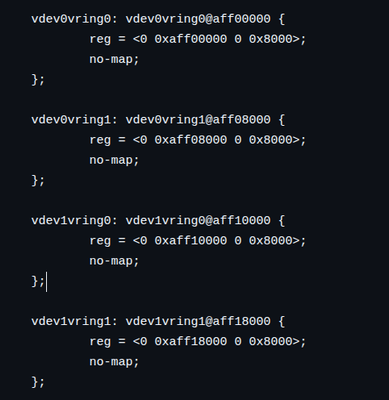

Thank you for the clarification. But actually, the address used in the Variscite Device Tree is also for DRAM:
You can try with SRAM.
Salas.

I tried to set up the vdev vrings as you suggested:
reserved-memory {
#address-cells = <2>;
#size-cells = <2>;
ranges;
ethosu_mem: ethosu_region@88000000 {
compatible = "shared-dma-pool";
reusable;
reg = <0x0 0x88000000 0x0 0x8000000>;
vdev0vring0: vdev0vring0@aff00000 {
reg = <0 0xaff00000 0 0x8000>;
no-map;
vdev0vring1: vdev0vring1@aff08000 {
reg = <0 0xaff08000 0 0x8000>;
no-map;
vdev1vring0: vdev1vring0@aff10000 {
reg = <0 0xaff10000 0 0x8000>;
no-map;
vdev1vring1: vdev1vring1@aff18000 {
reg = <0 0xaff18000 0 0x8000>;
no-map;
rsc_table: rsc-table@2021e000 {
reg = <0 0x2021e000 0 0x1000>;
no-map;
vdevbuffer: vdevbuffer@87f00000 {
reg = <0 0x87f00000 0 0x100000>;
no-map;
ele_reserved: ele-reserved@87de0000 {
reg = <0 0x87de0000 0 0x100000>;
no-map;
With the following in the M33 code:
#define VDEV0_VRING_BASE (0xAFF00000U)
#define VDEV1_VRING_BASE (0xAFF10000U)
The communication works fine when the A55 is not in suspend, but the M33 always crashes on rpmsg_lite_alloc_tx_buffer when the A55 is in suspend mode.
Have you tested this on your side? Is this supposed to work?
Thanks for your time and help.

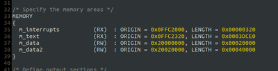

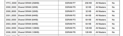

As I said before, that address is not SRAM. You can use the Shared SRAM:
Please take as reference the sai_low_power_audio example inside the SDK.
There you can see the linker file pointing to the SRAM:
