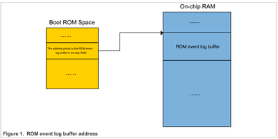

I want to get ROM Event on an RTOS application running on i.MX8MN.
How can I get ROM Event of i.MX8M series?
I read AN12853, but I couldn't figure out which one applies to i.MX8M.

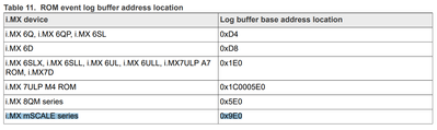

As you can see on the AN12853, the ROM event log buffer is located at a fixed address in the on-chip RAM:
Alejandro_Salas_0-1731425238092.pngAlejandro_Salas_1-1731425305468.pngAlejandro_Salas_2-1731425347877.png
Please refer to the Mscale Series.
Salas.

I'm currently trying to get mainline u-boot v2025.01 running on an i.MX8MM on a custom board. However, we're stuck in the boot loader and don't get output via serial interface. So, I connected a J-Link base and read out the registers. Found out that SPL obviously returns to Boot ROM (as the PC is in the Boot ROM range when halting the Cortex-A53), so I wanted to read out the ROM event log buffer to get more info.
Having found this post, I tried also with 0x9E0 as address, but the output doesn't seem to make sense:

J-Link>mem32 0x9E0 4
000009E0 = 0090E558 00000000 0090E6D8 00000000
J-Link>
Is 0x9E0 the correct buffer address also for ixm8m Mini (not only for Nano)? AN12853 is not very clear in this regard...
If this is correct, the read data doesn't make sense to me since the first 8 bits should be the ROM event ID (starting with 0x01), but were read as 0x00? Or did I make some mistake in interpreting here?

Check the OCRAM starting from address 0x90E558.
You should find the ROM event buffer there.
The OCRAM address pointed to by 0x9E0 should correspond to the ROM event buffer.

Thanks for clarifying! Could successfully read from 0x0090E558 and the value there seem to make sense.
