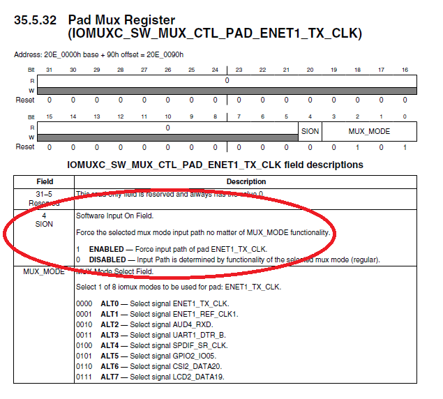

BiyongSUN
for the  RMII, the clock should be provided by the transmit side.
And please make sure, the pad configure as SION to loop back.
The RX side clock should provide by the phy.
8,735 Views

My code actually is the following:
arch/arm/include/include/asm/arch-mx6/mx6sx_pins.h has the following changes:
MX6SX_PAD_ENET1_TX_CLK__ENET1_REF_CLK1                   = IOMUX_PAD(0x03D8, 0x0090, 1 | IOMUX_CONFIG_SION, 0x0760, 1, 0),
MX6SX_PAD_ENET2_TX_CLK__ENET2_REF_CLK2                   = IOMUX_PAD(0x03E8, 0x00A0, 1 | IOMUX_CONFIG_SION, 0x076C, 1, 0),
board specific code looks:

mchaplet
Ok, it seems that it was only missing MUX_MODE_SION in Muxing :
#define MX6_PAD_ENET1_TX_CLK__ENET1_REF_CLK1 | MUX_PAD_CTRL(ENET_PAD_CTRL) | MUX_MODE_SION,
Now I'm able to send packet ... but RX doesn't work because the ENET_RX_EN signal is not wired on my board :-/
I copied my design from an iMX6Solo and it seems that RX_EN signal is now muxed on RX_CTL pad instead of CRS pad.
I need to wait the second board version .... :-(
