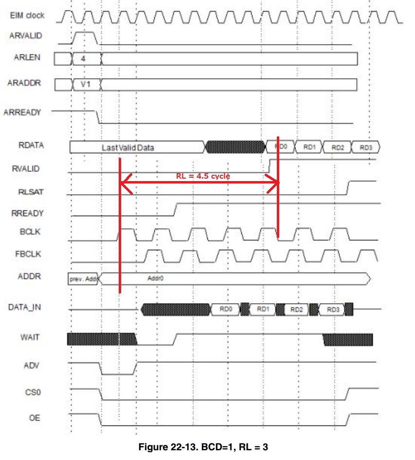

satoshishimoda
Senior Contributor I
Hi Yuri,
I checked a SRAM datasheet about read latency, and I feel RL indicates from latching address to output read data as attached image.EIM_RL.png
When BCD=1 & RL=3, read latency is 4.5 cycle as the above image, right?
If it is right, the Figure 22-12 does NOT indicate correct read latency, it seems 5 cycles even though it should be 1 cycle since BCD=0 & RL=0.

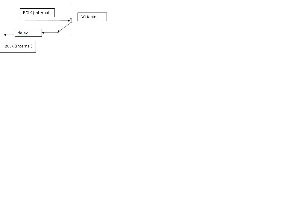

Yuri
  As has been mentioned, the pictures in the RM do not refelect exactly timing relationships.
RL parameters control loop delay between the I/O pad of the BCLK and the FBCLK (internal
signal), which is used to sample read data.
~Yuri.

Yuri
Please look at my comments below.
1)
> RL and FB_BCLK are only used when Continous BCLK mode, and they are also
> used in DLL internally for better syncronization.
RL and FB_BCLK are used for any synchronous accesses.
2)
> They don't affect on Data Read timing. so it's ok just looking at rising edge of
> the BCLKs to know when the Data is sampled.
   RL affects the Data Read timing, since it provides additional tuning for data latch timing.
3)
> When BCD is used, Continous BCLK cannot be used then FB_BCLK is no use.
This is not so. RL and FB_BCLK are used for any synchronous accesses.
~Yuri.
