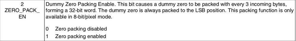

I've run into the same issue with an i.MX6ULL.  So no MIPI, but same 24-bit CSI interface.  PARALLEL24_EN in CSI_CSICR18 is set, and TWO_8BIT_SENSOR in CSI_CSICR3 is unset.  I get exactly what [email protected]‌ reported:  the (correct) 3 bytes of RGB24 image data, with with a 0-byte added to pad every pixel out to 32 bits.  Most frustratingly, CSI_CSICR3 has a ZERO_PACK_EN bit that purports to enable/disable this exact feature, but does not:
Just for the sake of trying everything, I attempted to set that bit as well, but with no change in behavior.  The throughput advantage of the 24-bit input is useless if the resulting image data needs to be software-unpacked to remove the zero bytes.  Certainly there must be a way around this?

andreasgustafss
For anyone stumbling upon this thread.
You cannot receive packed RGB888 (RGB24) from the CSI-reciever on the IMX6/IMX7/IMX8.
See: https://community.nxp.com/message/1290681#comment-1300322
What you have to do is enabling PARALLEL24_EN in CSIRC18 and receive the data as XBGR32.
