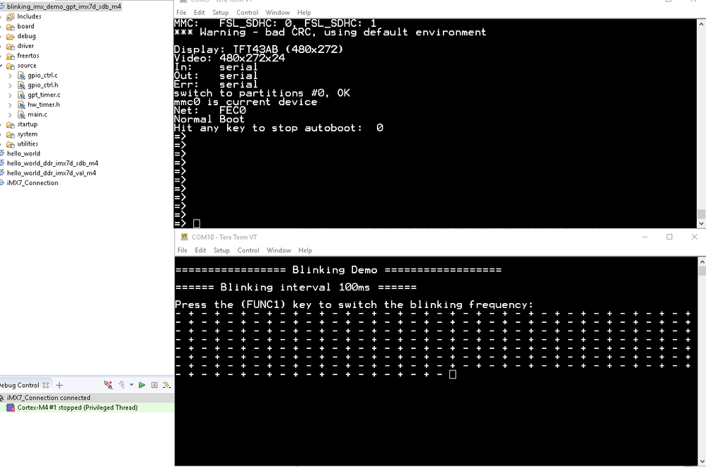

zhiqunhu
Hi Igor,
I am able to build and run project blink_imx_demo_gpt_sdb_m4, But I cannot see any LED blinking except the UART TX LED in Sabre since the terminal is updating, please see the attachment.2019-01-16 17_41_04-Development Studio Workspace - Development Studio - blinking_imx_demo_gpt_imx7d_.png
For my evaluation, I like to have many example projects especially these HW related projects working out, please let me know what is missing.
Zhiqun

zhiqunhu
Hi Igor,
Can you verify that imx7d_sdb_m4 is for iMX7D Sabre board, while imx7_val_m4 is for iMX7 Validation board?
If user has iMX7D Sabre board, it is needed to use the examples in fold of imx7d_sdb_m4.
I think that may be the issue I have here since I have Sabre but was using the examples in imx7_val_m4, that will not be the issue to run the project that does not deal with HW, such as "hello world" and son on.
Zhiqun
9,112 Views
zhiqunhu
After reading through FreeRTOS_BSP_for_i.MX_7Dual_Demo_User’s_Guide.pdf, the answer to my last question is YES.
If you have a Sabre, you need to run the example projects in imx7d_sdb_m4 folder.
9,112 Views
