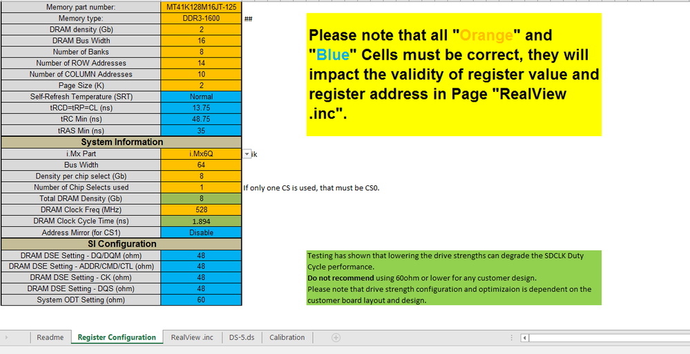

I noticed there are two different tools for DDR calibration:
- DDR3 Register Programming Aid (i.MX6DQ SABRE SDP/B DDR3 Register Programming Aid)
- i.MX6DQSDL DDR3 Script Aid ( i.MX6DQSDL DDR3 Script Aid)
What is the difference between them?
Which one should be used if I want to determine DDR initialization values to be used in u-boot?

Here recommend you to use the - i.MX6DQSDL DDR3 Script Aid ( i.MX6DQSDL DDR3 Script Aid). It's newer and have more option than the other one. When you open the link you can see the details.
The - DDR3 Register Programming Aid (i.MX6DQ SABRE SDP/B DDR3 Register Programming Aid) is only for MX6Q_SabreSD_DDR3_register.
