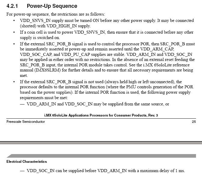

I would like to ask about the power-up sequence of i.MX6SoloLite.
Are there any restriction on the power-up order of VDD_ARM_IN, SOC_IN, PU_IN and VDD_HIGH_IN?
Can I understand that there is no matter whatever the power-up order of VDD_ARM_IN, SOC_IN, PU_IN and VDD_HIGH_IN is?

Hi Miyamoto
according to datasheet Power-Up Sequence requirements (below)
there are only some restrictions for VDD_ARM_IN, SOC_IN
