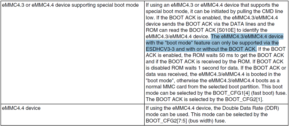

Dear team,
I would like to ask about eMMC BOOT of i.MX6SX.
My customer is trying to boot-up i.MX6SX from eMMC.
And they saw that boot cannot be done in the following case.
- LCD1_DATA04(SRC_BOOT_CFG04)=H, LCD1_DATA15(SRC_BOOT_CFG15)=H
For the other settings such as below, the boot from eMMC can be done.
- LCD1_DATA04(SRC_BOOT_CFG04)=L, LCD1_DATA15(SRC_BOOT_CFG15)=L
- LCD1_DATA04(SRC_BOOT_CFG04)=L, LCD1_DATA15(SRC_BOOT_CFG15)=H
- LCD1_DATA04(SRC_BOOT_CFG04)=H, LCD1_DATA15(SRC_BOOT_CFG15)=L
They are using eMMC 4.41 compliant chip, and they believe that FastBoot mode and DDR mode can be enabled simultaneously for i.MX6SX eMMC boot.
Is it true?
If yes, please let me know what they should do to achieve enabling both of FastBoot mode and DDR mode.

weidong_sun
Hello Masamichi,
    Sorry for my late reply!
    I checked errata for i.MX6SX( see document "IMX6SXCE.pdf"), There are no errors clarified on Fast boot with DDR mode in it, so Fast boot with DDR mode should be supported by i.MX6SX.
    I configured boot selection according to i.MX6SX EVK board, see following, please!
BOOT_CFG1[7:6] = 01     LCD1_DATA7=0      LCD1_DATA6=1           boot from uSHDC
BOOT_CFG1[5] = 1          LCD1_DATA5 = 1                                         MMC protocal
BOOT_CFG1[4] = 1          LCD1_DATA4 = 1                                         Fast boot mode
BOOT_CFG1[3:2]=x0       LCD1_DATA3 = x     LCD1_DATA2 = 0         Fast boot ACK enable
BOOT_CFG1[1] = 1         LCD1_DATA1 = 1                                          eMMC reset enabled via the SD_RST pad
BOOT_CFG1[0] = 0         LCD1_DATA0 = 0                                          Through the SD pad
BOOT_CFG2[7:5] = 110  LCD1_DATA15=1            LCD1_DATA14=1    LCD1_DATA13=0   8bit DDR mode
BOOT_CFG2[4:3] =11     LCD1_DATA12 = 1   LCD1_DATA11=1                          Boot from uSDHC-4 port
BOOT_CFG2[2] = 0           LCD1_DATA10 = 0                                             BOOT cpu /ddr Frequecy 792/400 MHz
In additon, see Table 8-18. MMC and eMMC boot details (continued) of reference manual.
In the list, Fast boot and DDR mode are described clearly!
Please let customer try above! If there still exsit issues, I will confirm it with i.MX Expert team!

jimmychan
I got the reply from the expert:
Yes, 6sx support ddr mode + fast boot mode.
But for fast boot mode, 6sx bootrom would not configure SD devices. So the customer need configure their emmc devices into ddr mode by ECSD register as default setting in advance.
9,650 Views
